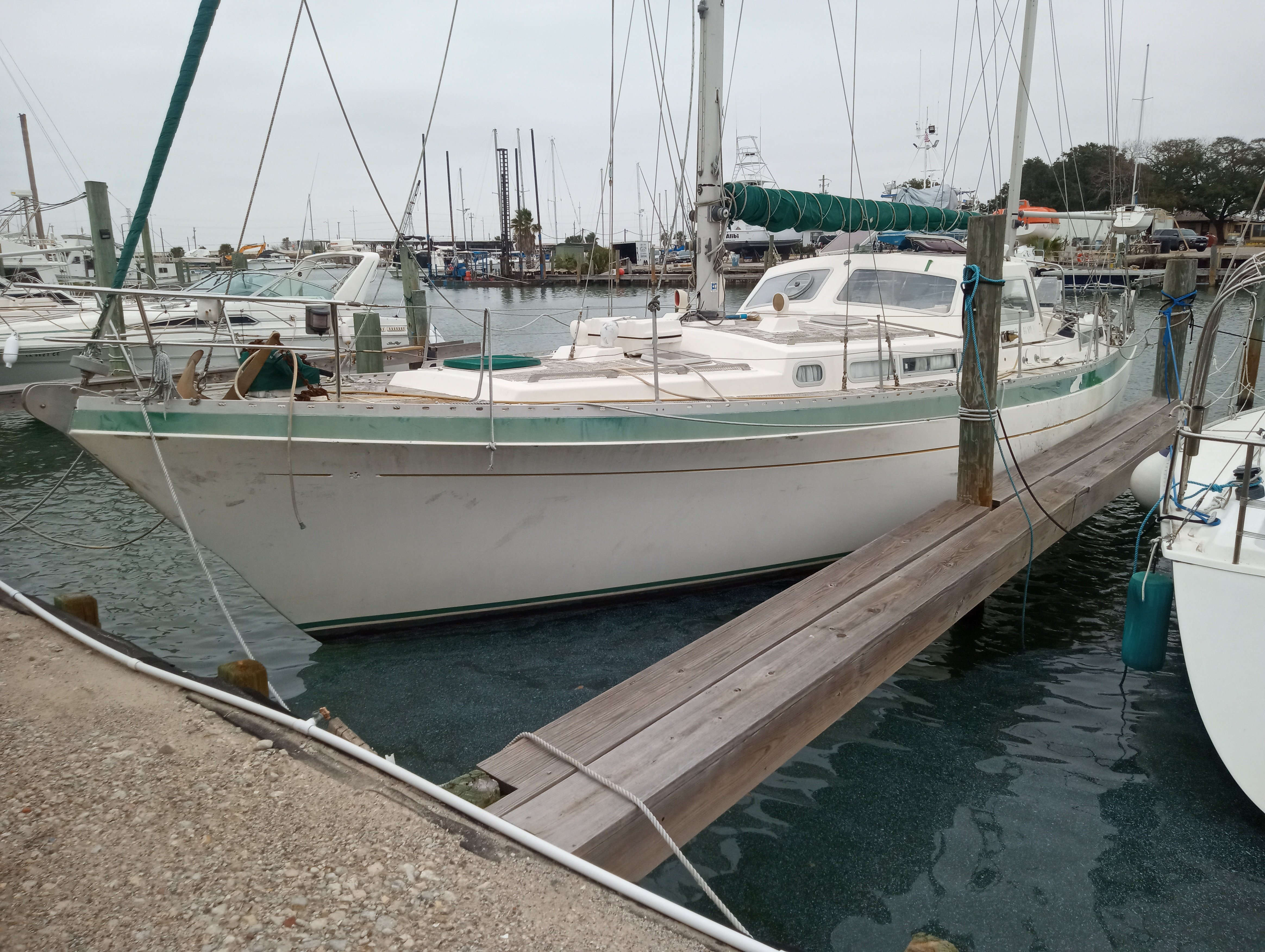

I am considering a 1978 Moody 42 CC. Is the keel molded integrally with the hull or bolted on. If bolted, will I have to cut through the interior liner to access/inspect for condition? This vessel has not been hauled since 2016 but other than minor storm damage, she shows well otherwise from the waterline up.

Thanks for the quick response.Do you know if leaks in the keel area are common with this design? The current owner
The current owner say the leak only appears when on the hook or at a dee water dock. The vessel now sits at a shallow dock. The leak disappears when she's sitting on the bottom.
