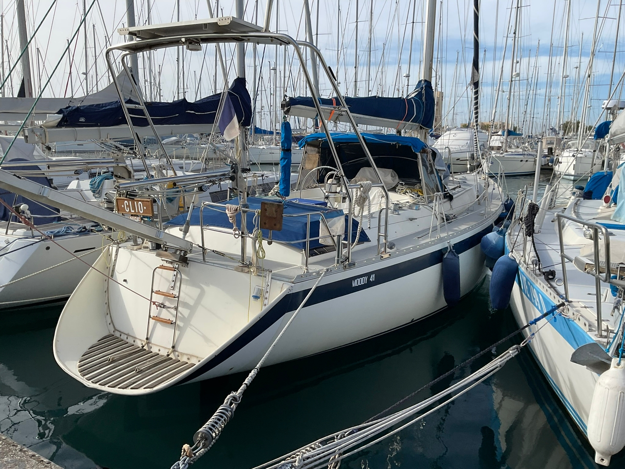

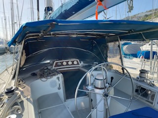

Ladies and Gentlemen let me present you “Clio”!!!
In few days will post more pictures and I will start with the questions!!!
Congrats - she looks great -
Fire away :cool:

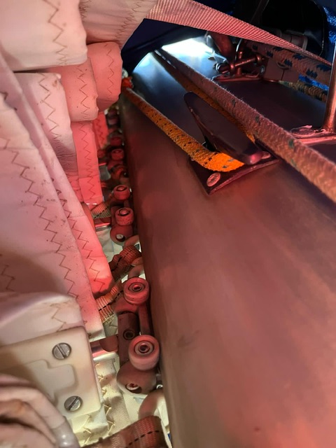

Sails are good for a couple of years, will have to replace the cars (hope is the correct English word )

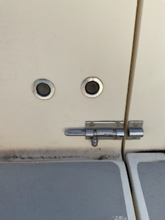

Can anyone able to tell me what are these ?
These are the cars I was talking about

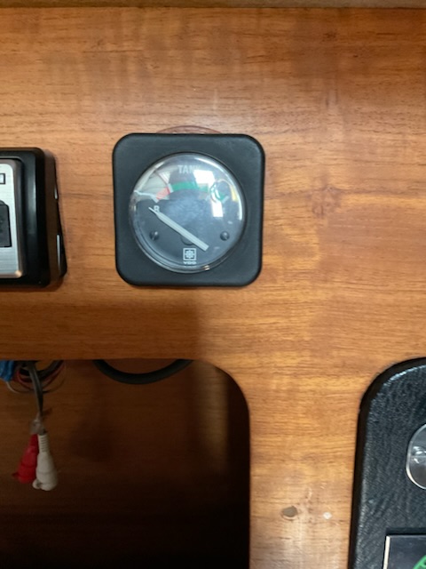

Not sure if the water gauge works, is this the original one?

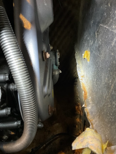

And this is one of the issues…the engine is a Yanmar, and look how close to the tank bulkhead is…was the original engine shorter?
Hi Aldo
These look like breathers for fuel and / or water tanks.
Moody had a habit of fitting them at the same level or only just above, the filler point so they can have a tendency to spurt liquid out as you are filling. Not normally a problem with water but hugely annoying when it's diesel
Regards
Peter
Aldo, Do check that the hoses from those two vents go up to an inverted U otherwise you will get water into your fuel tank and dirty water from scrubbing the cockpit into your fresh water. Look inside the cockpit locker immediately forward of the vents to see these pipes.
The water vent is only for the port water tank; the original starboard tank vent on mine was in the anchor locker high on starboard side. Previous owner had this blocked off and fitted a vent that ended in the heads just above the sink.
If you still have the fuel filler in the cockpit sole then do check that the seal is in perfect condition, I moved my filler to just inside the cockpit locker so that it is well protected.
Notice that you have a bolt to prevent the cockpit locker lid from sliding - very sensible. I achieved the same result by adding some wood to the underside.
Original Thornycroft engine was also mounted quite well forward so changing seawater impeller was a bit of a fiddle - home made puller makes life easier. With new Beta engine I bought a Jabsco made puller but had to modify it slightly.
