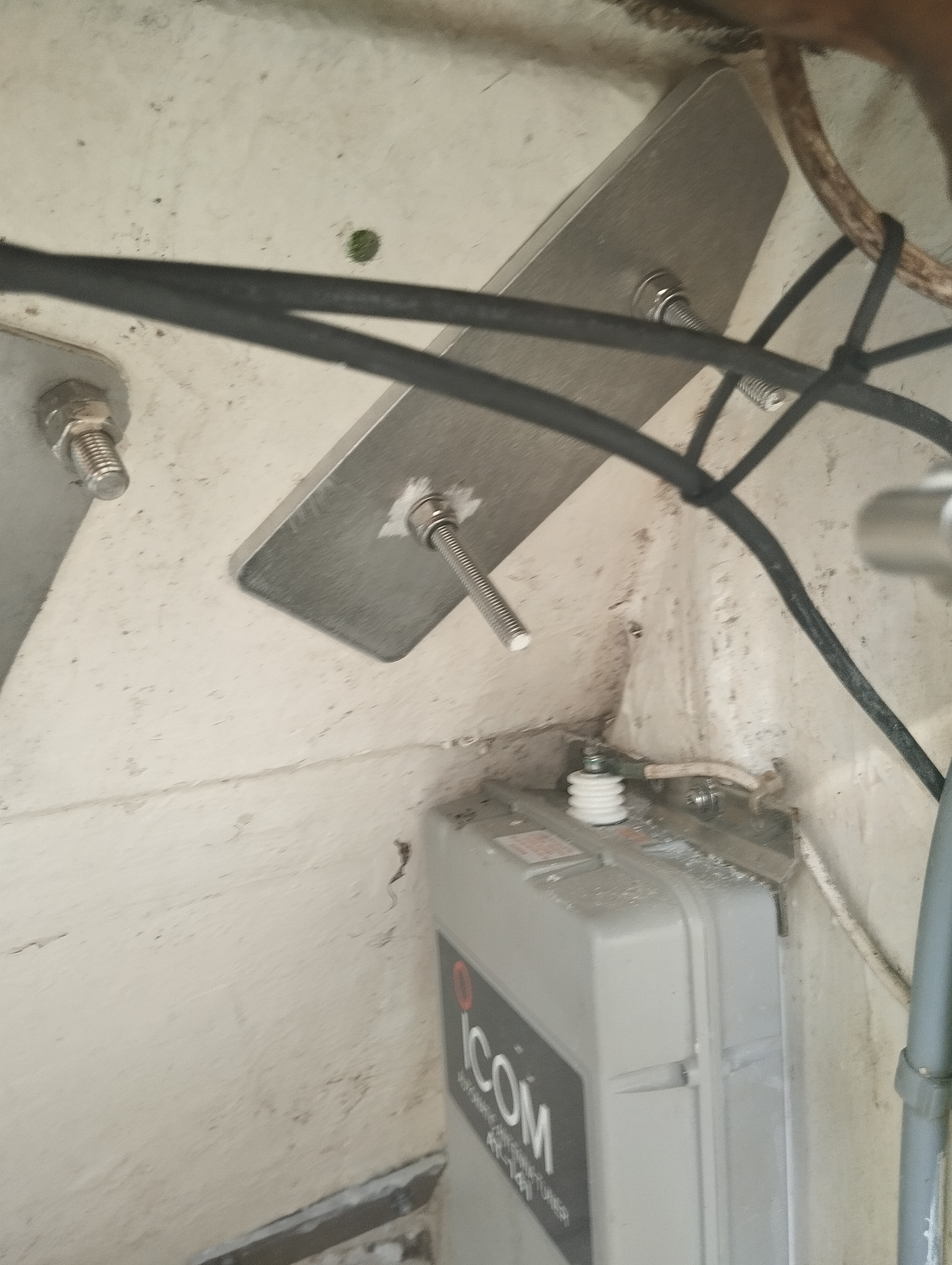

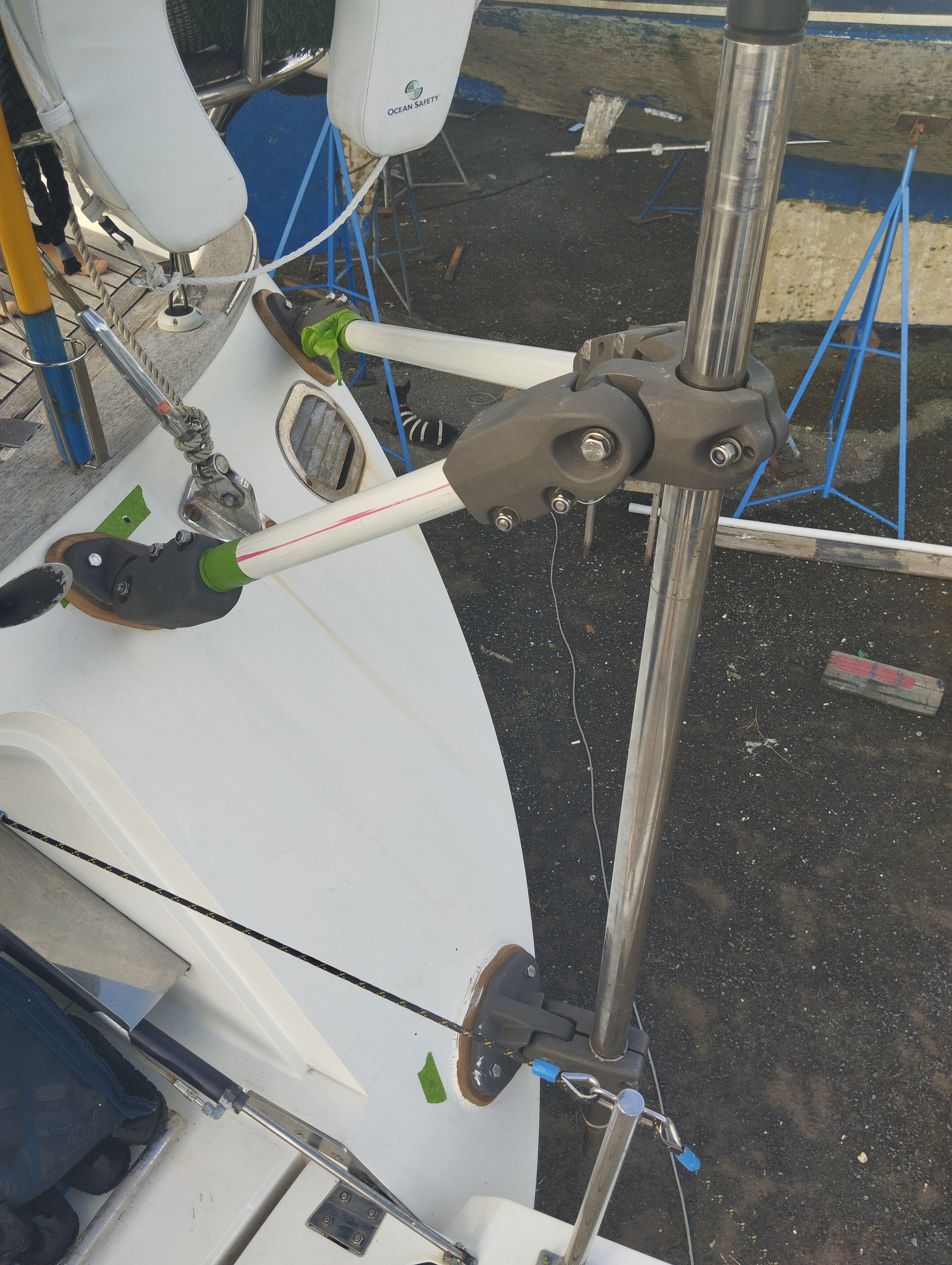

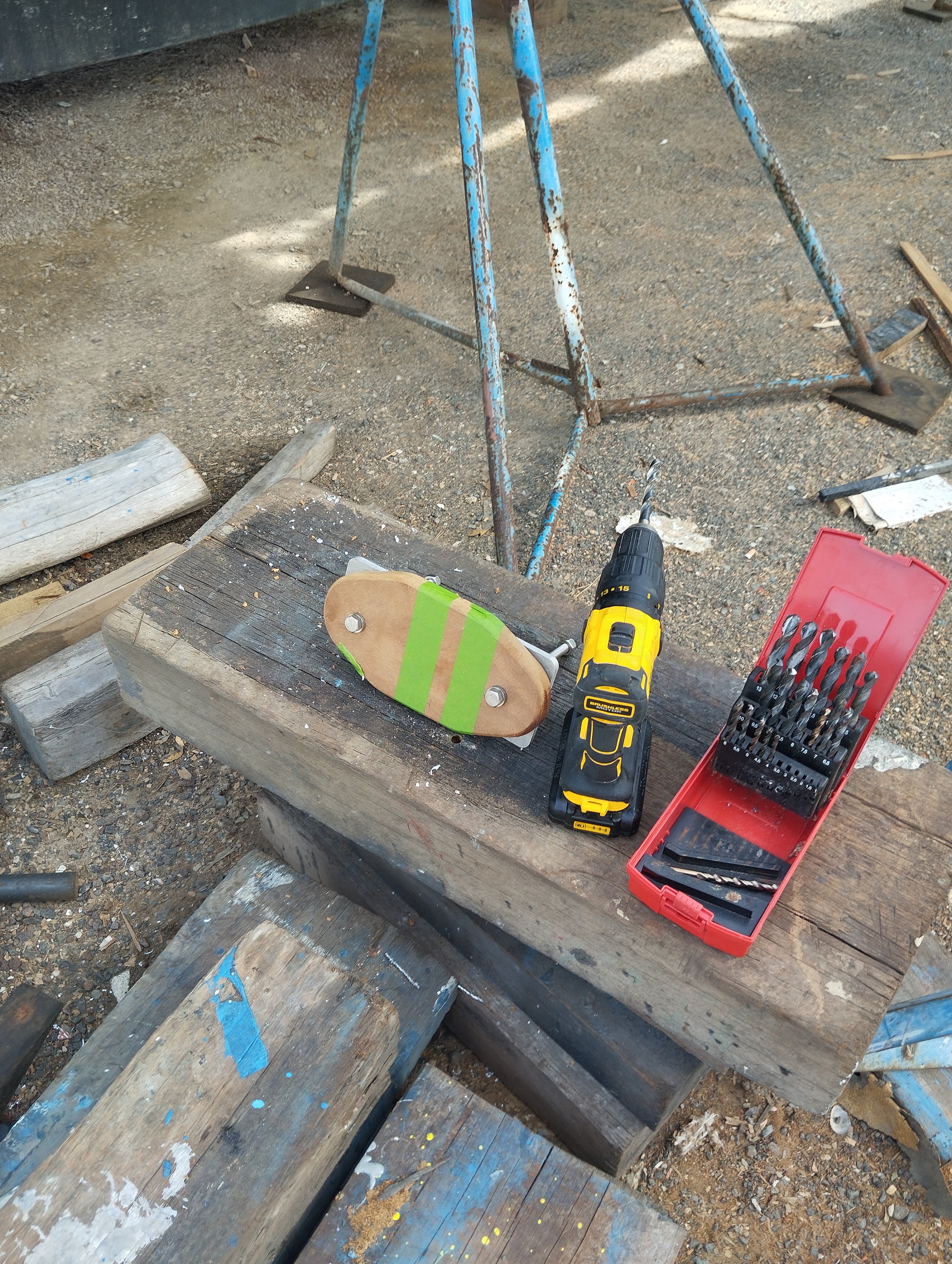

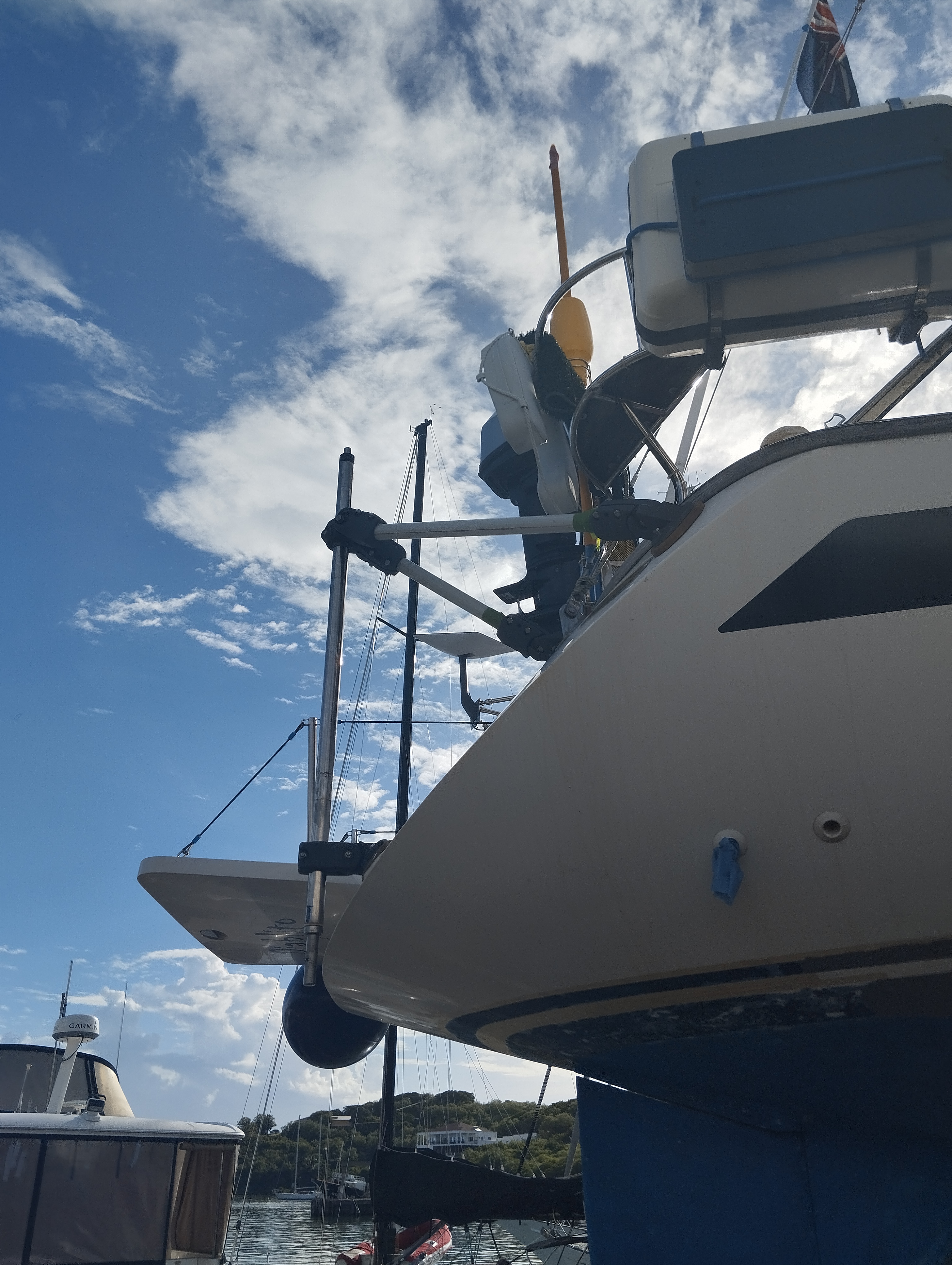

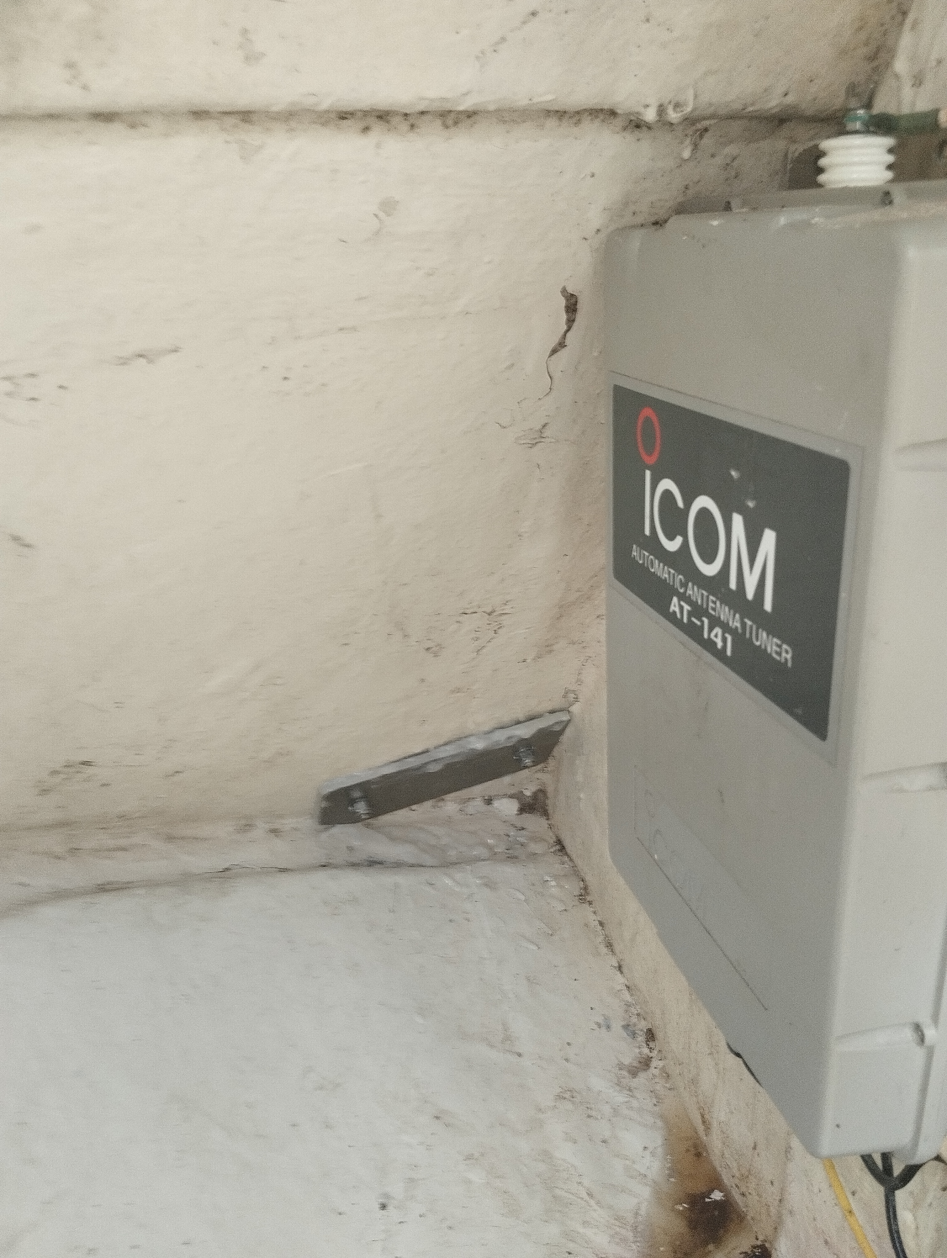

When we were out the water in Spice Island Marina, Grenada, I fitted our Hydrovane following the detailed instructions. It was not that difficult after I had worked out where to fit the brackets. I purchased the backing plates and pads from Hydrovane.
Here are a few pictures showing the backing plates in the aft lockers and the tubing we used to template the fitting etc
