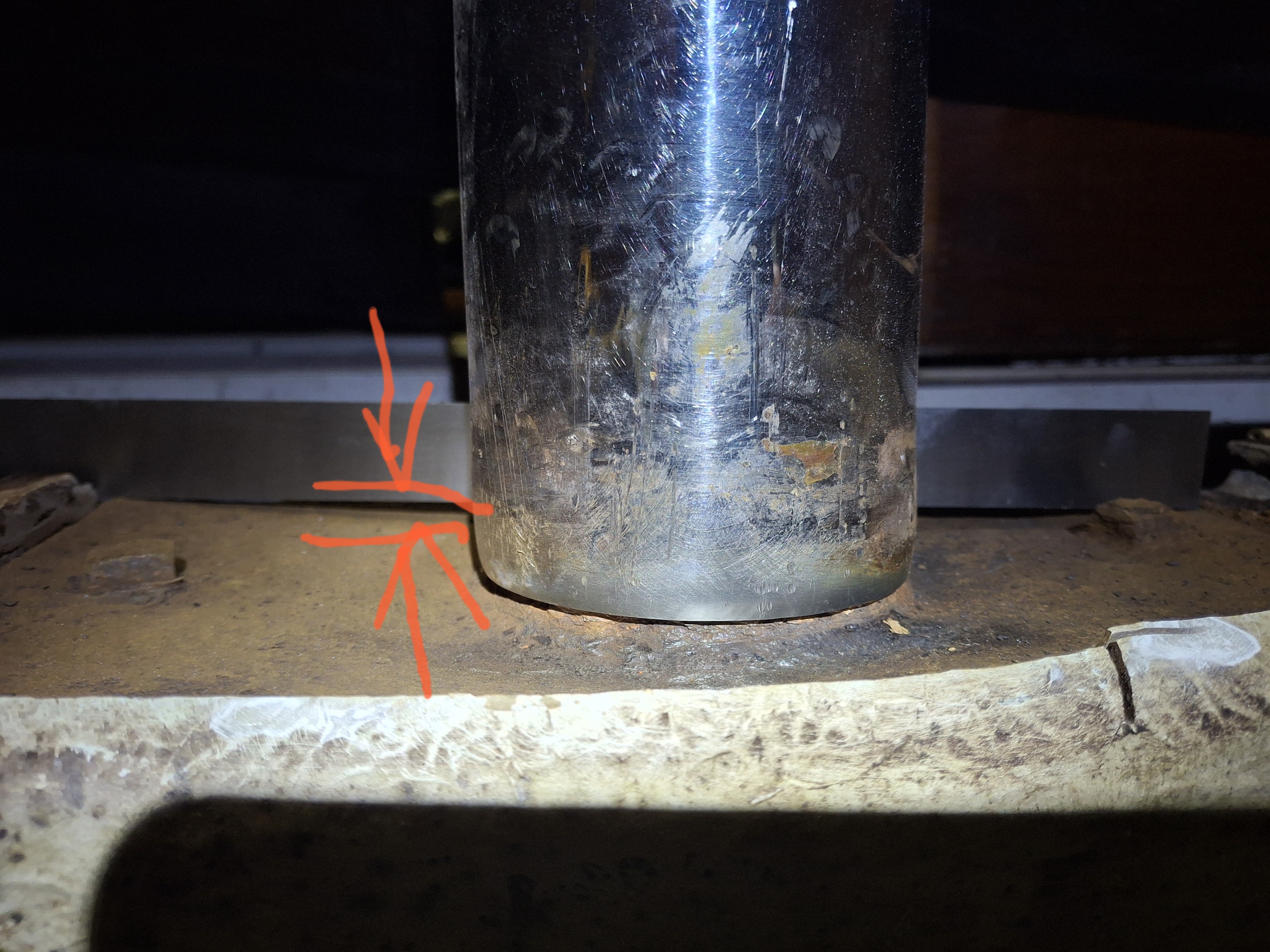

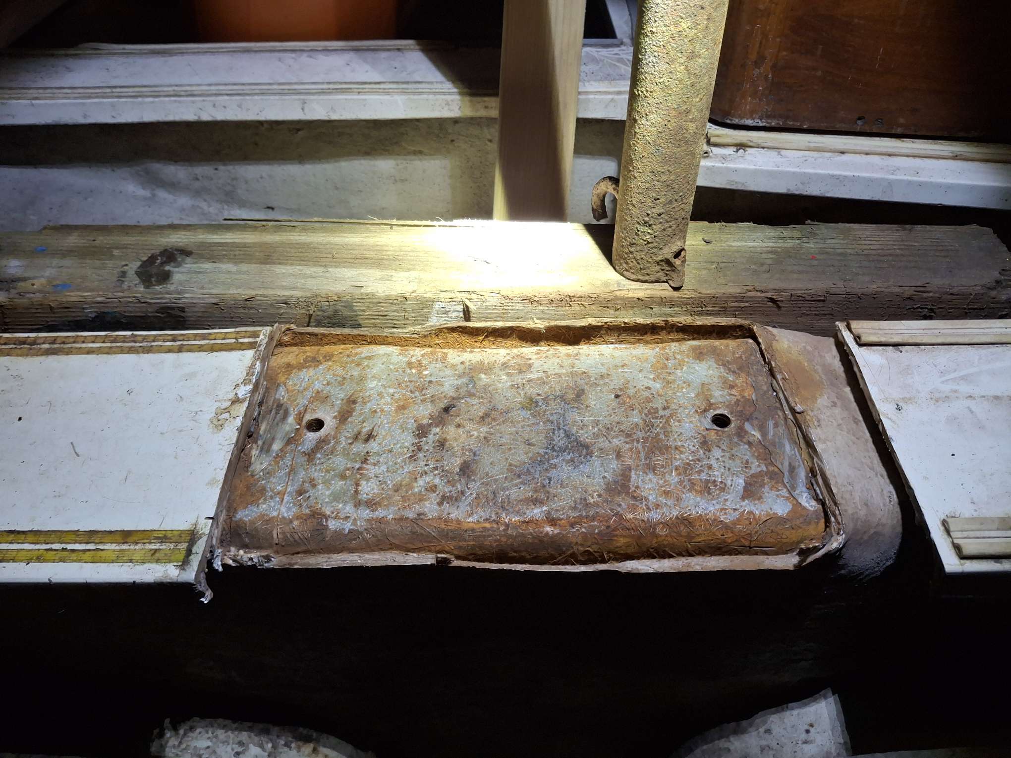

I'm very new to Moody 376 (new owner) and one of the first issues I have spotted is the completely rotten Compression post plate :(.
As I see it and correct me if I'm wrong:
1. Mast has to go down
2. A whole new compression post to be installed - fiberglassed back into the hull
3. make sense to install a new standing rigging ( 15+years) when mast is down in marina
All job to be performed by professionals, I wonder what kind of price tag I would be looking at £ to brace myself?
Anything could be done DIY to prepare it for marina and eventually save some costs?
And its only when everything else is good.
Pav.

Hi Pavel,
Welcome to the MOA, and sorry to hear of your problem.
Your description of the remedial work sounds not too far out, if you establish that it's really necessary but just occupies a volume 8 to 10 times te volume of the steel it comes from so, despite your photos, you may not need to replace the compression post. I would be inclined to chip and wire brush the rust off the foot of the impression post to see how much steel remains. If there is sufficient, the remedy might be as simple as cleaning up and recoating with something like Hammerite.
Whether or not you replace the compression post, it's worth checking that the floor on which it stands and the mast plinth in the deck , which stands on the top of the post are both in satisfactory condition to support the mast compression loads. If the floor needs some remedial work, that will probably require the compression post taking out anyway.
If you are not comfortable making judgements about the amount of steel remaining or the condition ofvthe floor / mast plinth, I would get advice from a surveyor or a shipwright you can trust.
If your standing rigging is 15+ years old, it's due for replacement regardless of the compression post issues, so it sounds like your mast will be coming down anyway. While it's down, it is certainly worth a full overhaul of the main and genoa furlers and a thorough check of all other features of the rig (spreaders, mast head and foot sheaves, genoa halyard defector) and all the mast electrics. I know ti's is more potential expense, but it gets the most out of the cost of taking the mast down.
The other job you should do while the mast is down is to lift the little sealing plates around the chain plates, rake out the sealant resealwith a modern sealant and rebed the plates. The original sealant used for these tends to dry out and crack allowing water to soak into the marine ply bulkheads to which the chainplates are bolted. In extremis, this leads to rotting of the marine ply, so allowing the bolts to tear through the ply and the chainplate to come through the deck dumping the whole rig over the side. Keeping these sealing plates watertight is the key to preventing this. As a separate job, you should arrange access behind the beautiful cabinets in the saloon to check whether previous leaks have degraded the part bulkheads. You can read of Mike Hallgarth's dismasting here:
And the repair here:
The post replacement job can be done without taking the mast down by using a couple of Acrow props, one each side of the post, but it seems to me you will be taking your mast down anyway. Personally, I would replace the compression post with a new one in type 316 stainless steel once it has been removed, regardless of how much steel has been lost
You have already saved a few labour hours in getting access to the foot of the post and could really save more by taking down head lining to give access to the top. A key hassle is removing the table from the post which can put hours on the job, it's not clear what whether you have done that yet.
Lastly you are clear that you own Moody 376 yet in your name window it says you have a Moody 38 (2000s) this based on data you provided when signing up for membership. These are two completely different designs. You can update your membership details here:
The update will not happen immediately on clicking submit as it requires some input from our membership registrar, but it usually gets done within a few days.
Any further Qs just ask away.
Peter

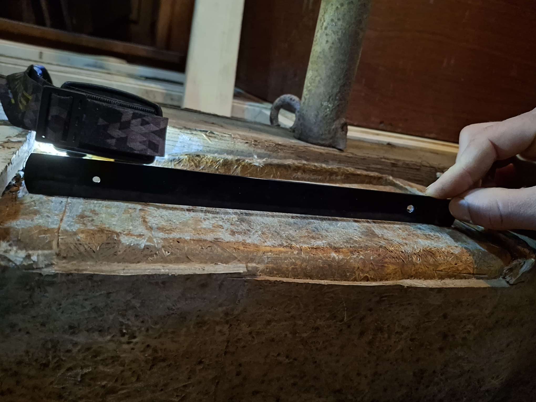

After removing all the rust flakes with hammer this is what has remained. About 3mm thick plate still attached to the post. It started to bend a bit as it is only 3mm thick now (i believe it was at least 5mm+ as new. What do you recon, still sailable far from the coast?

Hi Pavel,
If it takes 1 man a week to do the job at £60 an hour that will be £2400 - doesn't leave much for materials! At today's cost of employing people the man won't be earning much either. £1800 to drop the stick seems a bit much. Do your prices include VAT or not, but it's not cheap to keep a fully inspected and certified crane waiting for such jobs.
I will fix the compression post myself and let you know how many hrs it took me = never done such a job before! It will be interesting to see - there is a great article by Mark Prior who did the same job also on Moody 376. I have managed to drop the price down for the mast removal/re-installation to £1400 as I will remove the boom, sails and electric myself. All the price quotes are including VAT
