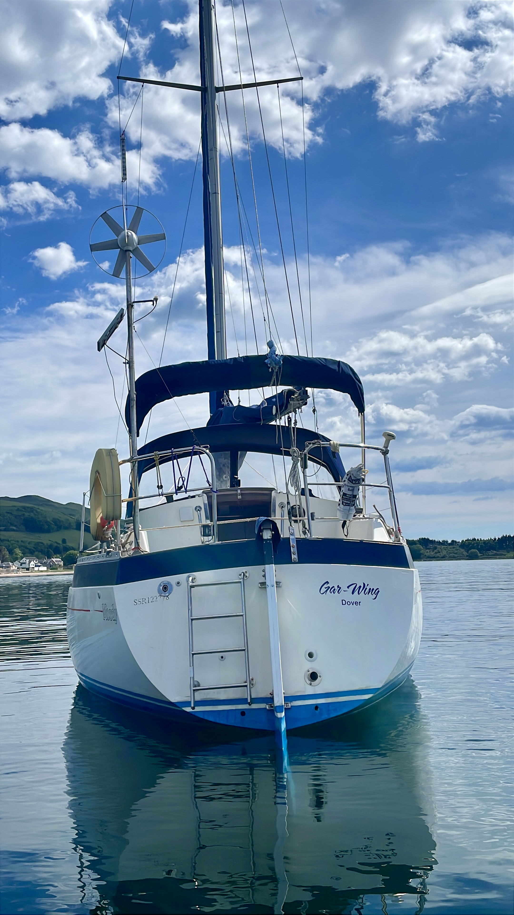

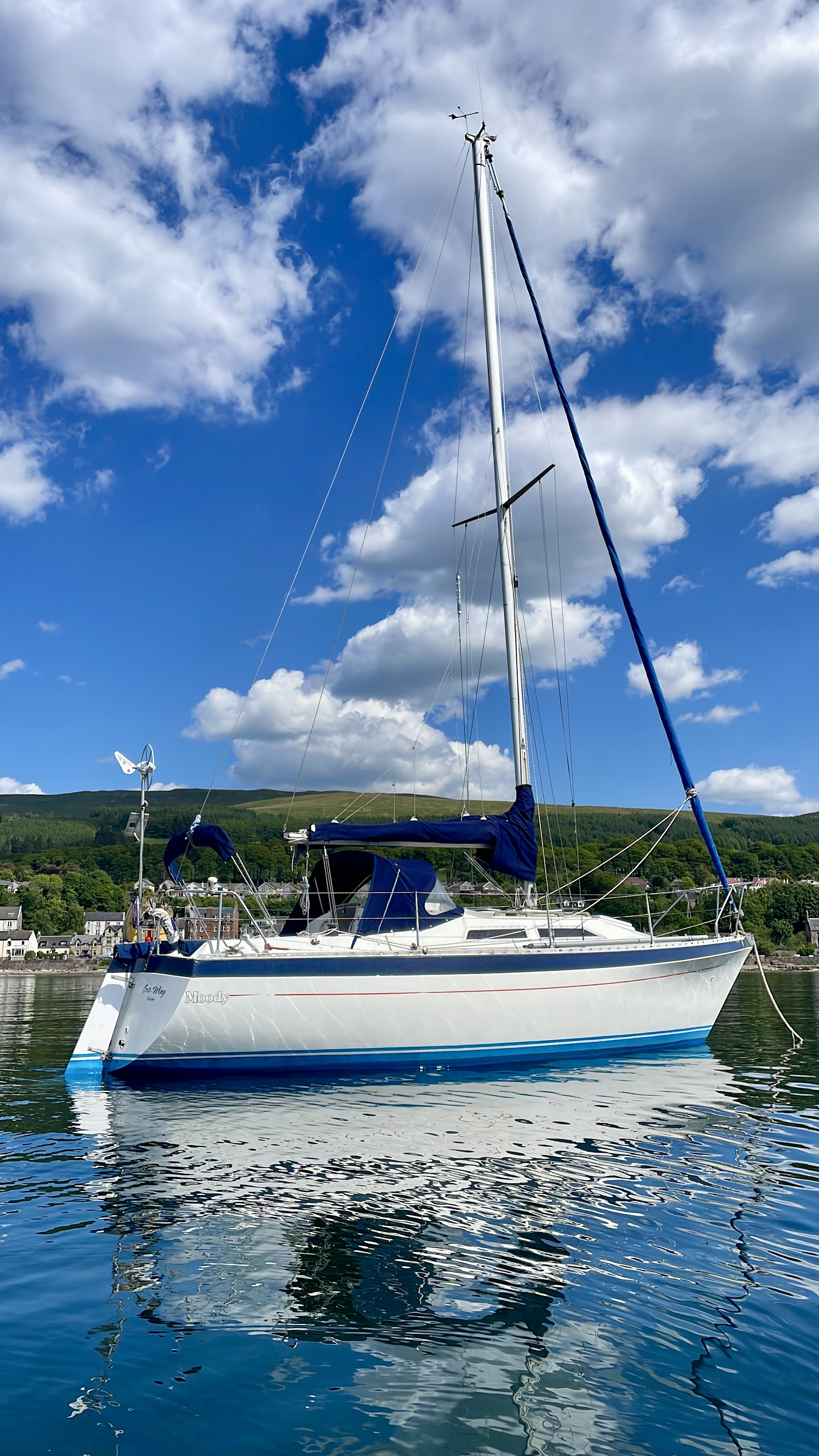

Very well but she’s up for sale as I split up with my partner and had to extend my mortgage - otherwise I would keep her !
Thanks - sometimes that’s the way it goes - one step forward and two steps back !
